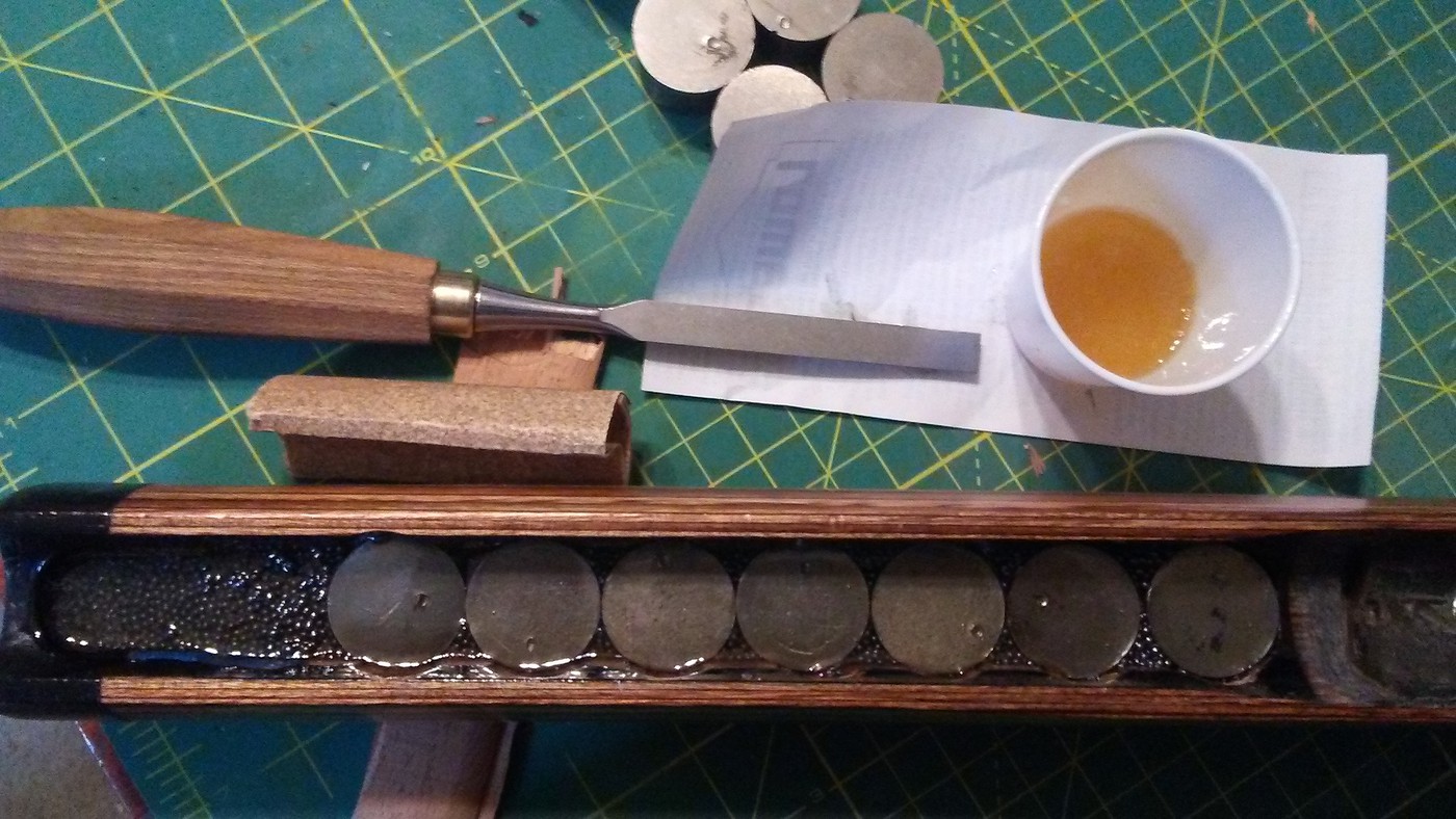

The Savage BVSS stock is fairly chunky. Lots of places to add weight. I had a gunsmith mill a trench in the barrel channel, hollow out the grip, and hollow out the buttstock. The magazine well is also a place to add weight (it will use a Savage Precision Target Action. Single shot).
I bought a bunch of scrap Tungsten off ebay. It's "Mallory Metal"; cylinder shaped slugs for balancing crankshafts, and 2.6 times heavier than lead shot encased in epoxy.
The barrel channel took 7 pieces that weighed 7.5oz each. The magazine well took 2 of those, plus a larger one that weighed 18.8oz. The grip took two pieces that added up about two pounds. The buttstock took ten or eleven of the 7.5oz pieces, then I filled in the gaps with 4 pounds of cerrosafe. With a Savage target action and a 30 inch MTU barrel, it adds up to 31 pounds without a scope. Yeah, it's nuts, but there is no law requiring me to go hiking through the Rockies with it. If a friend wants to shoot a Remington Ultra Mag but is afraid of recoil, they can shoot it in this stock.
One word of caution about the Cerrosafe; it expanded and made a small crack. I'll fill it with epoxy. In hindsight, pouring in epoxy would have been more practical, but this project was not about practicality. It was a quest to see how much weight I could stuff into this stock.
The barrel channel with Tungsten slugs. Spaces filled with lead shot and epoxy.
