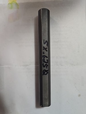

a tungsten rod would be the way to go, however I do have my buttstock already half empty due to rad2a inlet. Drilling the forend may be too risky.

Thanks, but mercury is unsafe to me. I just need simply added weight. The whole drilling will have to be done in buttstock I guess and tungsten rod will have to be glued in somehow. I will figure that out. I would feel better with a chassis but no one produces chassis for single feed actions like bat.

I try to avoid lead at all cost. I even switched to lead free hunting bullets. I will have to asses the safe thickness of tungsten rod I will glue in the buttstock. I don’t want my dima stock to break. I will let you know how this works out. Thank you to everyone in this thread for helpful advice and inspiration.
