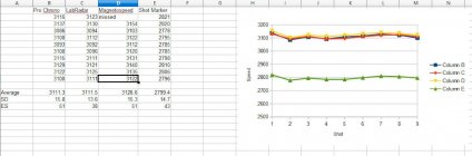

Have a suggestion for you ; and please do not take it in any negative light , as it is not meant that way . Find a local shooter who can teach you about Brass preparation for competition use . I say this simply because I looked at your chart and graph, and the SD / ES was rather high across the board . This is usually a indication of Brass not being prepared with correct deburring , neck tension , etc. , etc. There are so many ways to get Brass prep wrong , but only a few ways to get it right . And it does have a major effect on load development .
No offense taken but if you are referring to my post that was simply 20 rounds of ammo I loaded to test the accuracy of the Shotmarker's velocity info back when I first acquired the to see if it could be used to fine tune BC's I just loaded some 80 grain bulk bullets behind a middle of the range powder charges. I just happened to run into a friend who had a Labradar and he was kind enough to set it up for me. I am damn glad he did though because to me it proved an optical chrono set up on a sturdy tripod with sunshades at the proper distance is plenty accurate for load development. I also keep a MS sporter in my bag for quick spot checks to verify my scope DOPE.
I don't compete in SD contests anyway.I have a .223 80 grain load that shoots sub MOA consistently out to 800 yards. the ES last time i checked it was a 150 something ish.
