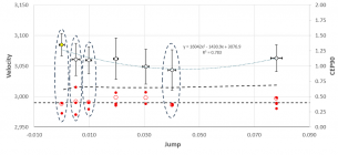

On the topic of velocity dipping between a long and short jump. I've seen that too. I can't recall where I read this (might be one of either Harold Vaughn's Rifle Accuracy Facts or Jeff Siewert's Ammunition, Demystified: The (non) Bubba's Guide to How Ammo Really Works), but this is a result of how the bullet interacts with the leade in the throat. In summary:
(a) At a long enough jump, a bullet can deform as it "slams" into the rifling. Then needs more pressure to force it into the barrel.
(b) At a short or jammed jump, the static engraving force needs to be overcome and that force can be 20 - 50% higher than the dynamic engraving force. This means more pressure is needed to force the bullet into the barrel.
(c) In between that long and short jump is an optimal jump, which may or may not be the point of best precision given other factors, i.e. barrel vibrations (nodes).
There's a lot of extra information on this chart, but this is for my .222 Remington from a range day last week. The upper line (curve) is velocity, and it shows velocity dropping to a low point at ~0.040" jump. Before doing this test, I fired 5 foulers. Note though that the velocity error bars (+/- 2 St Dev) are tall relative to the average velocities (note - some jumps were 10 shot and some 20 shot groups), but I saw what I had read about.
