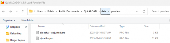

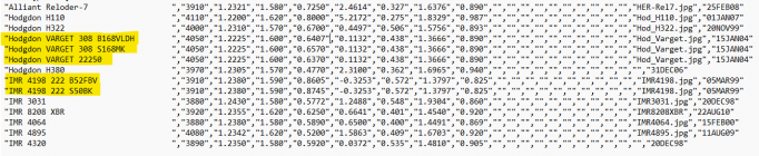

Did you know that QL also allows you to create your own powder files? I copied their file, changed the name of it from "qloadfw" to "qloadfw - Adjusted" and then input my own Ba values. I then name the powders according to the caliber and bullet they were determined for.
A side benefit of this is I could also erase the hundreds of powders I'll never use. I keep the original file "just in case", but it does make my life using QL a little simpler.

To open, edit, etc. the QL powder file, use Notepad which is an option in Microsoft (if you're on Apple, I've got no idea). I opened the file, then saved a copy in the same location with a different name. Then when I open the powder "folder" in QL I have two files to select from.
