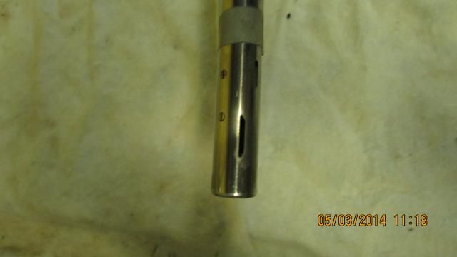

You do not have to down load the 300 to be a great deer rifle. I had mine Mag Na Ported use hand loads about 2600 fps and 165gr Serria HPBT game king bullets. Nice thing about Mag Na Porting is you do not get that noisy back blast like you do with a brake. recoil is milder than my 7mm08 too.
