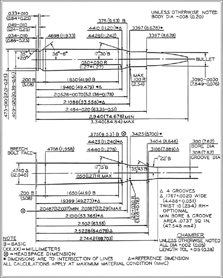

I think this thread got derailed and turned into a pissing match between Uncle Ed and Bart. It started out as a meaningful thread of importance of runout and turned into a personal vendetta. Chambers as big as some referenced have nothing to do with runout. Most guns on here are custom chambers and alot tighter then those recently referenced. Matt

I measured that actually happening. My Mauser type claw extractors push case rims against bolt face shrouds or case body back ends against chamber walls when bolts are in battery on a chambered case. Some of us have the wherewithal to do that. Others can easily figure it out. The naysayers and disbelievers are something else.
Thats gotta be a pretty sloppy chamber. I agree the mauser claw is strong and can push a case but in reality the mausingfield is the only action used in modern times that has that extractor and nobody in the game theyre used in cares about the runout issues. It just doesnt matter that much

Chanbers are SAAM minimum spec, not sloppy.
I don't think it matters of there's .0001" or .0100" clearance from pressure ring to chamber wall. All extractors push case heads sideways. Unless there is zero clearance from case rim to bolt shroud.
I agree, rurnout ain't a big issue. There's bigger fish to fry. 1% of bullet diameter is good to go if measured the right way.
