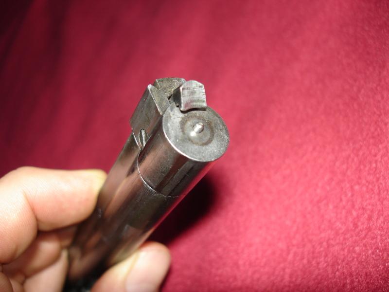

Below is a .303 British Enfield bolt head and it does not support or hold the rear of the case. And the same applies to the Ruger #1 single shot rifles. Also a neck sized case has no head clearance and is held against the bolt face.
And below is a modified No.4 Enfield bolt head for the .223/5.56 cartridge with a recessed bolt face that does support the rear of the case.
