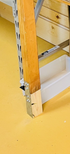

Finished the new bench today, instead of bolting things down I bolted press, powder dump and the case sizer to oak planks. I then can just clamp them in place tried a couple of 45-70 cases and nothing moved everything is solid as a rock. Also, a package showed up today the #1 son and da wife purchased me a new shaker.
Nice job on a solid bench. Im on my 3rd iteration now and feel like i have what works best for my needs now after having used a couple different setups. Everyone has a process and preference and if it works for you then thatts what matters. My first setup was in my small shop. Had moisture issues moved inside with a solid bench. Now at the new house i have a dedicated room built in my shop just for reloading and storing components. I have both above bench shelves and a 52" toolbox on the opposite side of my bench for all the small parts and tools etc. One thing i would reccomend is routering in some aluminum t-track. Makes for a super solid mounting option. I can remove my presses and set out of the way if needed. Also have a gun vice i can attach to the track etc. Really handy option. My bench is 11' long.
