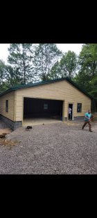

28x32, 10foot high walls
2x6 frame
40 year steel roof , facia. Soffit.
Grade build up
Slab
Block
200 Amp
Log siding
Pella windows/door
Shell was 65k
Not sure your location but I do this everyday and would love customers with your budget!
2x6 frame
Grade build up
Slab
Block
200 Amp
Log siding
Pella windows/door
Shell was 65k
Lol.
Looks very nice, Just not for me. Yes metal roof, and siding is the way to go in my book, Your building does look very nice though, Good job!
2x6 frame
Grade build up
Slab
Block
200 Amp
Log siding
Pella windows/door
Shell was 65k
Lol.
Very nice. Maryland, I see?
