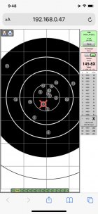

Never took 5 in a stand but have put a bunch of bullets in a 10” circle at 800 yards from an AR with iron sights. Not 20 at 1000 yet only 12/15 but working on it. Smallest ring is 10” second ring is 20”. 88ELD M in a 24” with a +2 gas system. 2800 fps MV.DD244185-E806-4ACC-8974-7A6F9527FB5B.jpeg7B24B27C-4707-4E60-85B9-38BC87DD285B.jpeg
