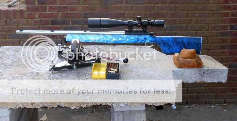

Stiller Tac 30 Action bedded as a single shot in a Shehane ST1000F,Krieger .236 4 groove 8 twist 28 inch HV throated for 105s,,Jewell trigger,,Barrett Zero Gap Extended Range rings with 8-32 Sightron MOA-2 reticle,,
shot off Farley Coax II edgewood front and protektor rear bag off concrete bench,,
