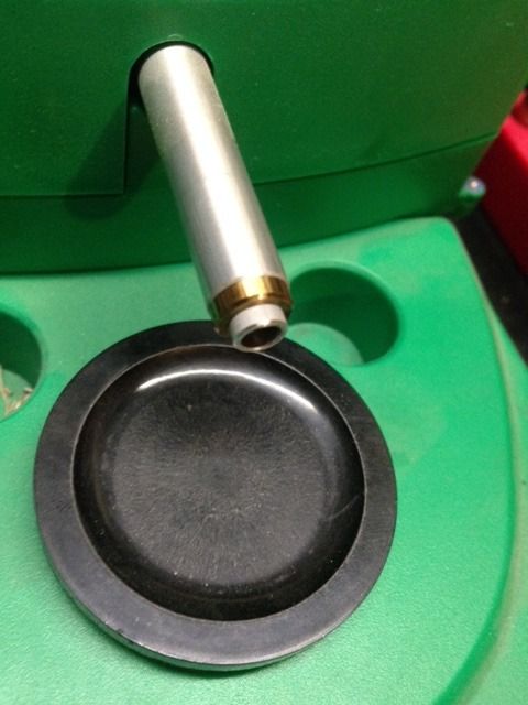

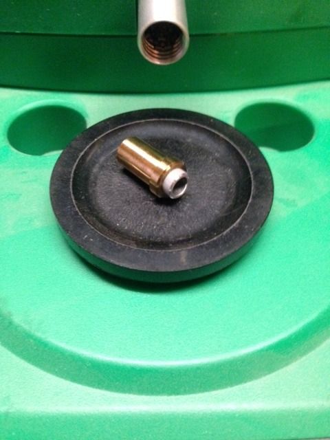

Brass or Aluminum reducing inserts for Chargemaster
Ok guys, I've got something new for you to try. I've made an additional reducing sleeve that fits inside the insert for an even more precise throw and even fewer overthrows. Downside is it slows the toss down about 10 seconds over the normal insert (42g H4350). I've had some very good results myself and a buddy has had the same results but I want to get some out in the wild for more feedback. They idea is to give the option of choking down small for when you want to be as precise as possible and aren't worried about the extra time.
The next 3 guys that buy the regular insert will get this additional reducing sleeve - I'd just like to get some feedback once you have a chance to try it. PM me.
recieved the reduced sleeve about two days ago. loaded up about 25 rounds to do some load testing with. Then did addtional 25 throws just to get some stats.
Cons
It does in fact take a bit longer to load the pan with my desired 42 thru 45 gr. ( i knew about this going in)
Pros
Used a old article on the bulletin to re-program my CM to gain most of that time back. That was lost from the restricted flow.
NO over throws in any of the charge weights i threw even the odd ball weights. Using IMR4064
I watch the individual kernals fall into the pan as it trickled in to the final weight.
OVERALL
Really happy with the investment looks alot cleaner than my McDonald straw and does what it is advertised
