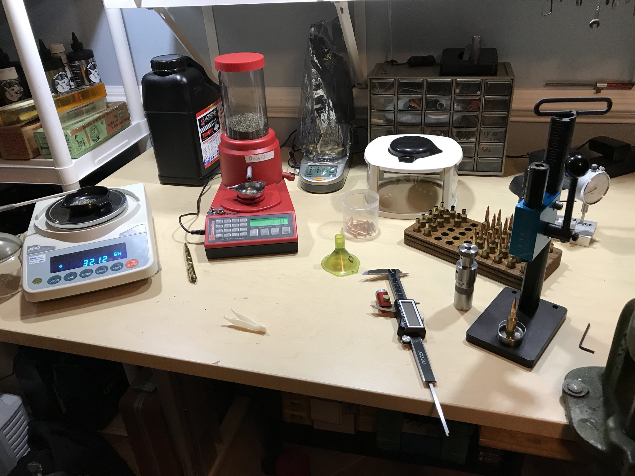

Roy was throwing that Forster bushing BR die in the garbage can. I rescued it because of the unknown and the expense. Glad I did because - it was an issue of BOTH consistent seating depth and run-out. First took that die apart. Replaced an "O" ring and studied out its' operation. Compared it to the other BR seating die without the micrometer adjustment that seemed to be way better.
After discovery I found out it actually takes, after bullet pulling, TWO passes through the Harrell's die to get the necks back straight. Now as I sit and play re-doing some BRA from another lot, I can really see differences in bullet quality between Roys, Barts, VT's and Bergers. Night and day repeatability and you can guess the specifics. Picture is right now......
cSuzI68hQgWlHc4OlpKRFQ by Larry Malinoski, on Flickr
Will try Roys 108's for the first time tomorrow with H4895. The "repair" I am working on right now had Varget in it. Just re-doing, checking run-out and seating with care. They seem to be way, way, way better.
