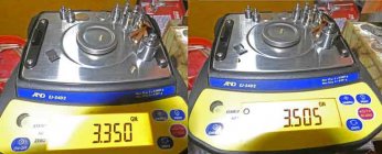

I sort out the outliers by weight.
I weigh and tare an empty tray, transfer one flat of primers to it and determine an average for that flat of 100.
So far, about 5 flats of Ginex weigh about the same.
I then find the light and heavy outliers, maybe 2 or 3 per flat.
I'll load those that are within +/- 1% of the flat average. (3.390 to 3.460 grains)
One day I'll shoot the light vs the heavy.

A few of the better shooters got me into sorting. I normally
shoot LRP's in the BR2 flavor. The first time I did this with a
tray of 100, I made 7 piles and found 2 outliers and both were
real lite. Sorting a tray of Federal Champions had piles all over
the map with a good 25% I would call outliers. I did not buy
these for match's, but for fire forming. With the BR2's, I would
average 2 to 3 primers I would cull. The lighest primer of the
BR2 tray, gave me a 35 fps drop in velocity. A sorted pile would
show SD's in the 4's.....

Wayne,
Do you sort primers by weight ?
I find myself not only testing primers side by side on paper but sorting in gram mode.
I may need therapy …
Jim,
I have before but at that time I didn’t notice a discernible difference. But as stated buy other members we weight sort everything else lol. I try to test at the distance I’m shooting and that’s usually 1000 yards, so getting good conditions for an optimal test is difficult where I live. I can test at a 1000 on my own property so that’s nice. Someday when I fully retire I can do more testing on primer sorting.
Wayne
