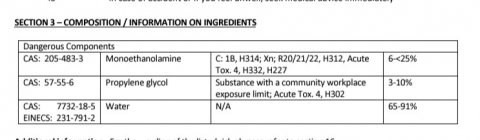

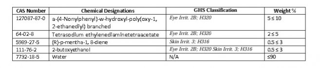

Bore tech C4 and Cu+2 are water based products. Let's use our heads here folks, you don't put water in your bore as the last step.
I have been using these products for several years and have not had any corrosion problems...... BUT, I always clean them out with a dry patch, then run a [patch with oil to lubricate the bore before storage. Kroil for short term (a few days) or Hoppe's Lubricating oil for long term storage.
That's the rub....
1) No where on the bottle that I have seen says it's water based.
2)The directions explicitly state it is a reasonable, and I would go as far to say, a recommend practice to leave it in the bore as a short term protectant.
So if you are just a normal shooter and not a forum goer, using our heads means following the manufacturers directions.
If something is considered a short term protectant, it should never cause long term damage. It should just stop protecting.
