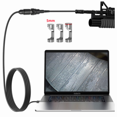

Had a Lyman for 250 bucks, it quit working after a year, got a Teslong for 50 bucks, M-100 flexible .199 cable, works for everything 20 caliber UP, Digital Quality Pictures
I have a question: I'm looking at the Teslong, and want to use it to look at my two 20 caliber rifle bores, (unfortunately my 17's are feeling no joy). The mirrors start at .223 caliber, it does not show a mirror usable with a 204 barrel. Does anybody have a Teslong and use a side viewing mirror in a 20 caliber barrel?
"The updated version suitable for barrels of .22 /.243 /.30 /.38 /.40 and more calibers barrel."

I'm looking to get the Teslong, probably the WiFi version NGT100W, just have that question, will that unit have a 45 degree mirror to look at the bore side directly that will function on my 20 Caliber bore? The listing shows it only comes with .22 /.243 /.30 /.38 /.40 size mirrors, that means NO on .20?
If someone who has one that could verify, one way or another, that would be great. Thanks!
I'd buy it tonight and have it on the way if I knew the answer was yes.
i can't speak to what is being shipped now days. but mine from a couple years back was marginally tight in .20. it was not the mirror housing, but the mirror itself. i put a bevel onto the mirror while slightly reducing the diameter using some very fine abrasive paper iirc. mirror packs used to be available so i could source a backup if i ham fisted the job.

From what many others have said in previous posts, it appears that the mirror may not fit. People seem to be using just the unit without mirror for a direct view. Not as efficient as seeing at 45 degrees, but might still work for you. I have nothing but praise for the Teslong units and have several versions but I don't have any .20-calibers. I do have .17s and they are definitely a 'no-fit'.
nope... mine fits .20 (now)

Looks like the version with a solid rod is favored over the soft coil? Seems like it would be easier to view, but I've never used either. Also sound like people also prefer the Wi-Fi version from what I'm reading?
Your choice depends on a few variables - flexible is much easier to transport. Rigid is a bit more precise when using. WiFi is essential if using IPhone since the phones don't supply enough power to run the direct-plug models. Direct-plug works great with laptops or android phones, making this version far more portable than a WiFi version. I have two flexible and two rigid (rifle and handgun lengths) in both direct-plug and WiFi versions and usually just plug it directly into a laptop I have positioned above my cleaning bench. If headed to a shop, the flexible version is coiled in my pocket so I can plug into my phone to check out barrels before I make a purchase - a practice that has more than once kept me from purchasing used rifles with shot-out barrels.
