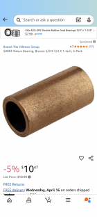

I've previously used takeoff SS barrel steel for bolt sleeves on chrome moly 700s but the lubricity issue has piqued my interest.
This looks like an option.
For those in the know...Is any bronze bearing material suitable? Screenshot_20250411-101708.png
PTFE impregnated delrin would help lot with wear issues as far as using plastic goes. Glue it with Black Max and it likely won’t be going anywhere.
