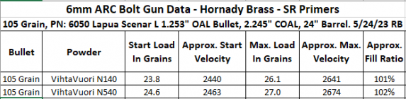

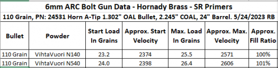

Anyone loading the 6mm ARC with 105-110 weight bullets for a bolt gun with VV powders? I have some VV N135 on hand but looking like N140 would be a better choice from burn rate chart but VV doesn't list any loads for the 6mm ARC. I am waiting for barrel for my bolt gun so just trying to figure it out before it gets here. Trying to get them in the 2700+ range which looks doable from my 26" barrel in a bolt gun. Any info would be great. Thanks.
Got some info from Vihta Vuori for the 105 Scenar, 108 ELD and 110 Atip. The warning below came with it so figured I would forward it as well. I only asked about these two powders as they seemed to be the two that set in the same burn rate as others used.

I sent the request through their site and received a personal response with the info. Might be different now from when you did it.

Yeah I saw some of that but was looking for some first hand but seems like not a lot of people doing it but with the VV info I should be good to work something up.
