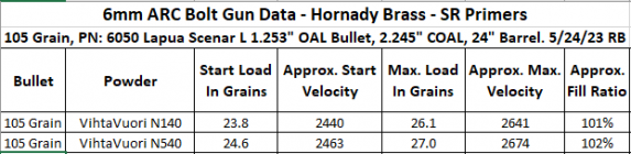

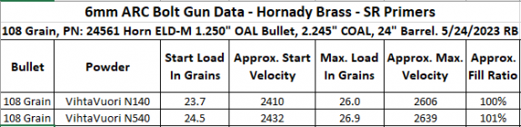

Anyone loading the 6mm ARC with 105-110 weight bullets for a bolt gun with VV powders? I have some VV N135 on hand but looking like N140 would be a better choice from burn rate chart but VV doesn't list any loads for the 6mm ARC. I am waiting for barrel for my bolt gun so just trying to figure it out before it gets here. Trying to get them in the 2700+ range which looks doable from my 26" barrel in a bolt gun. Any info would be great. Thanks.
We can help you with this load data. Please contact us at: support@capstonepg.com
Thank you!
Here they are. AGAIN THESE ARE FOR BOLT GUNS ONLY. NOT FOR ARs!
Warning!
Recipients of load data and/or product technical support from Capstone Precision Group LLC, assume all risk, responsibility, and liability for any injuries (including death), losses or damage to persons or property (including consequential damages), arising from the use of any load data or product, whether occasioned by seller's negligence or not. Capstone Precision Group LLC, neither assumes nor authorizes any person to assume liability in connection with the use of any data or product provided.
Always begin load development by using the minimum load data and approach maximum load data with extreme caution, as all rifles and reloading techniques differ. CAUTION: If you substitute or change any components (including lot numbers for different powder, brass, bullets, and/or primers), you must restart the load development process by returning to the minimum published load.

I have a 6 ARC bolt gun with a 26" barrel. My go-to load is a 105 Barnes Match using N140. I use 26.8 to 27.2 grains with a CCI 400 primer. Bullet is seated -0.016". Velocities: 26.8 grains = 2692 fps; 26.9 = 2702; 27.2= 2728. I use necked down Starline 6.5 Grendel brass.
Not the fastest, but by far my most consistently accurate load for my rifle. I extrapolated Hornady 108 gas gun data to develop this load. Looks consistent with the data from VV you provided - thanks!
