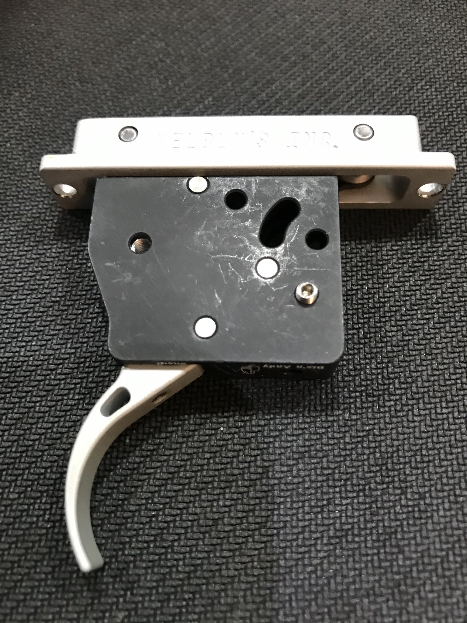

Sticking out the side of my trigger was this screw. It is used, along with another captured by the hanger above, to push out the side plate for service. Mine backed out. Alex Wheeler told me that was NOT causing my long-term trigger issues. Alex was right.
Soon as I started to remove the hanger I immediately noticed the rear hanger screw was loose. Cannot tell you if that was the problem. Do know you could push the trigger side to side before this service and final tightening. When pushed to the side it would not fire. Once it fired just lifting gate bolt handle. Often it just would not release.
After tightening and cleaning, I cannot duplicate any of my earlier issues. Now the cleaning may also be part of the issue. I just do not know but there was residue from some kind of fluid on some parts.

Re-assembly is not difficult. Just remember to re-set those two push screws. The upper one is inside the hanger and once set below the side cover, is not an issue. The one that backed out in those pictures may be best set to touch the side plate after re-installed with the four plate screws. Hopefully it will not vibrate back out.
My testing now shows no issues that I could duplicate. No side play in the trigger and a solid and consistent release. Setting the sear engagement and weight (1 1/2 oz for me) is easy and repeatable according to the instructions.
