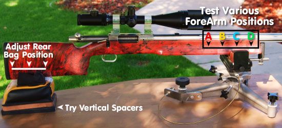

I have used a Star Shooter bipod in F-open for a while and liked it. I have only just moved over to a co-axial rest and I'm still trying to get the hang of that...trying to sort out torque twist and a front end prone to lifting at the moment.
Try adjusting the placement of your rear toe and fore-end in your bags. Ray Bowman designs the low-boy stocks to have a longer "wheel-base". This is supposed to reduce mistakes in handling, and in addition to the lower bore axis may help with torque.
I was also shown recently on the firing line to adjust the front stopper on the rest so that the fore end is in the "D" position as in this picture.
http://www.accurateshooter.com/shooting-skills/optimize-your-rifle-position-on-rests/
If you're having rocking port and starboard (left and right). You have a flat fore-end. The stock is rocking on the "crown" of the front bag. You either need to have the stock routed for tracking rails. Or put tension on the middle of the front bag with a band or rope.
