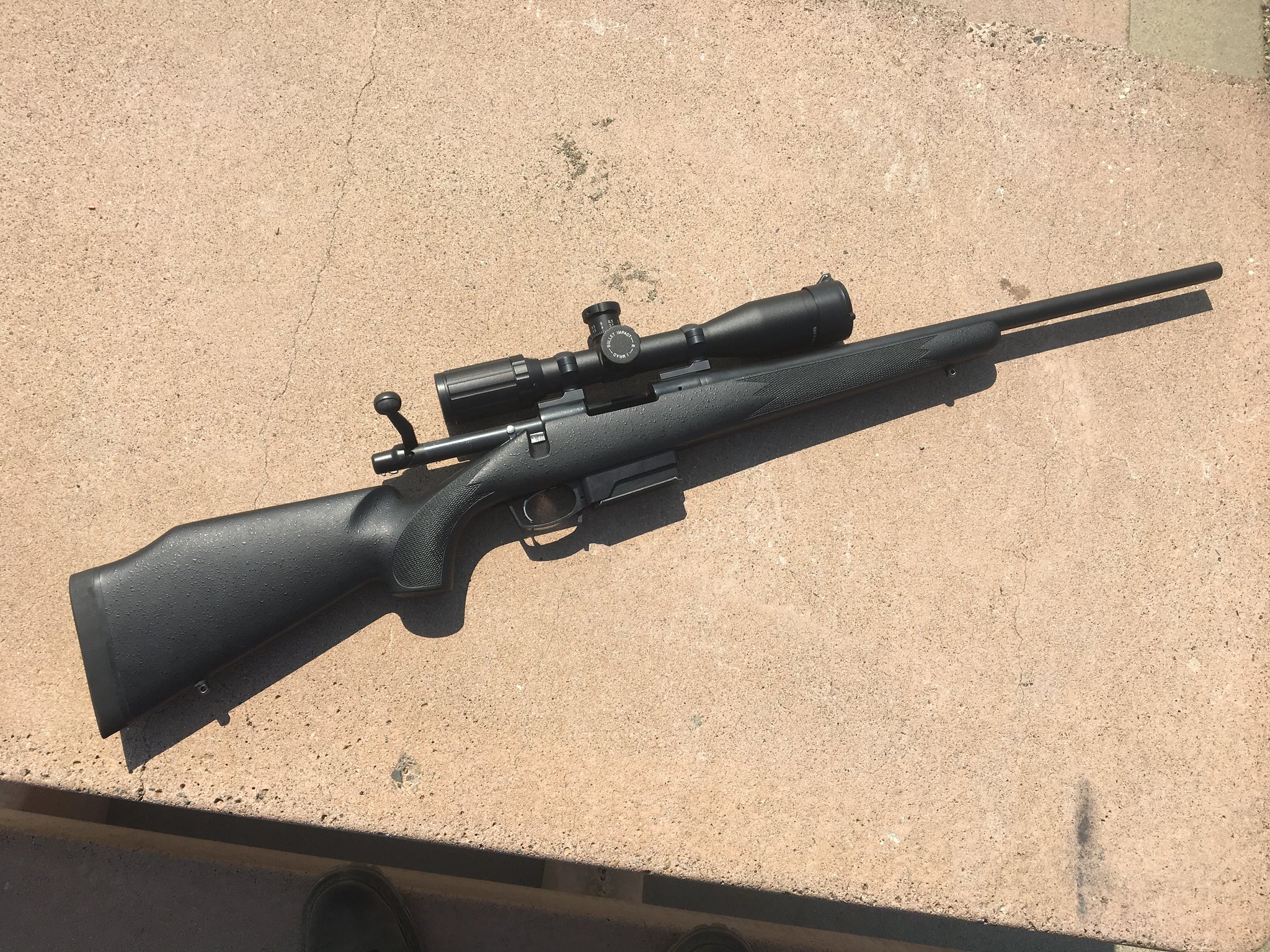

Bartlein 2b 7 twist @ 21" .223AI in an Edge fill McM Hunter, PTG Stealth dbm, TT Diamond, Dual Dovetails and a 6x SWFA Milquad.
It'll look something like this sans the 700.
