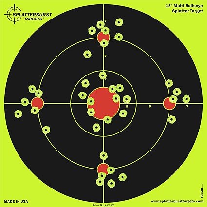

If you don't have a target cam, and you want to definitely see your bullet holes at 500+ yards, you can get a splatter target. The high contrast works.
Purchase LINK: https://amzn.to/38dKmZC
Downside -- it will be hard to discern true group size through the scope until you measure the physical target, going center to center of the shot holes. But you will be able to see the group location even at extreme range.

paper of splatter type targets makes getting a real group size pretty tuff.
Boss: As I explained, measure Center to Center of the Bullet holes, as the outside edges can be distorted. C2C will work reasonably well for training.
