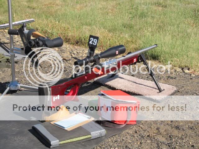

A pair of Nikon 12X binos on a modified arm attached to a RAY VIN stand. Get to see lots of the range and mirage info is decent. Depth of field lets me pick up mirage at various distances at once. I can also see the mirage at higher elevation if shooting into a hill..... kinda neat.
