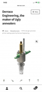

This isn’t a hand primer, but won’t add space to your bench top since it fits onto your loading press. The primer feed lets me prime pretty quickly. Not cheap, but I expect it to last a lifetime:
That looks interesting but I don't have a press or anywhere to put one. I'll be using a Lee Hand Press, thus my hand priming tool inquiry. Hopefully one of these years though. :)
