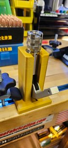

I have the Sinclair. Purchased a bunch of .001" shims to help with fast seating depth adjustment.
Also I printed a 3D base for it. The base helps with fatigue.
Is the file to print this base available online? I have a Sinclair primer and would like to try that base for it.
