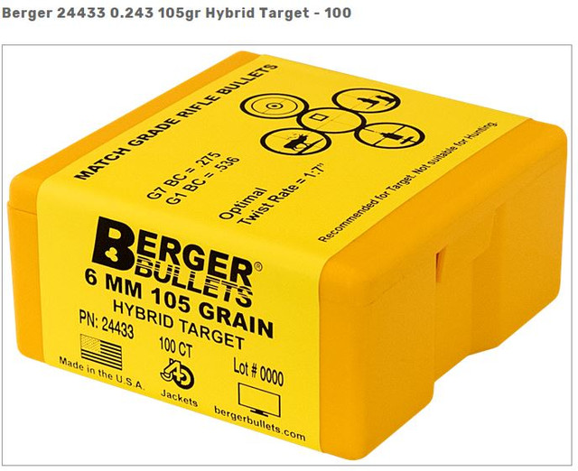

Everyone with the 105 Hybrids, what is the barrel twist you are using? Since Berger lists a 7" twist needed, I have yet to pull the trigger on them.
Alright, WTF! Went back to Berger's website and either I have been smoking the wacky weed for the past two months when looking at it or they changed the Hybrid from 7" to 8".
The Hybrids shoot just fine from an 8 twist at 1,190 ASL.
Lloyd
At 1.266-inches OAL, they have an Sg value of 1.38 at sea level and 59-deg F. Take that to 3,000 fps, 1200 ft ASL (~ 1-inch of mercury less pressure) and say 70F, it rises to exactly 1.50 in 1:8, so you achieve the now recommended magic number.
Even in lower altitudes and a chillier ambience at nearly 1.4 Sg it's going to shoot well - according to Berger's twist rate calculator you lose 3% average BC value though reducing it to 0.268 ..... which just happens to be what the 108 is reckoned to be under these conditions in a 1:8 barrel give or take the odd 0.001.
So, for many people using 1:8s, the choice between this pair is six of one, half dozen of the other ballistically (not that their full BC values of 0.267 v 0.275 will be noticeable for 99.99% of shooters' results) and the other issues - cost, availability, ease of tuning, results - are best to make a choice. I found the 108 a super performer a long time ago - and crucially very easy to 'tune' - so it's been my favourite 6mm ever since. Being a poor retired old git, I can't afford these fancy Hybrids anyway. :(
