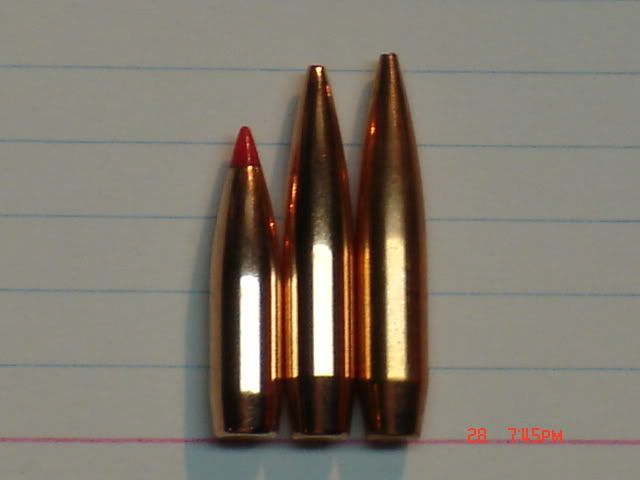

6br also has a longer neck and will allow more bullet veratility. As you can see in the pic below, that might be appreciated when shooting an 87 in a 105 throated chamber
87/105scenar/115DTAC
the 107SMK and 105 scenar are so similar a pic of the 107 is unnecessary.
