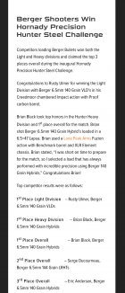

It’s just a steel shoot but here’s a perfect example of what I’m talking about. Berger takes the whole board at a Hornady shoot.
Mic Drop! LOL!
