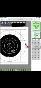

After supply issues here in South Africa we started testing the 208s. We started seeing great results
around 2610-2625fps and 2650-2660. But the lower node did a better job on the waterline over 20 shots. Ballistics isnt everything. We shot the 208s next to the 20x in team matches and the 208s did better. The waterline was more predictable on the 208s.
No "WTF" shots that the 20x are known for ....
The team switched over to 208s for the Worlds... the rest is history.
FYI-- N150 was powder of choice over Varget.
