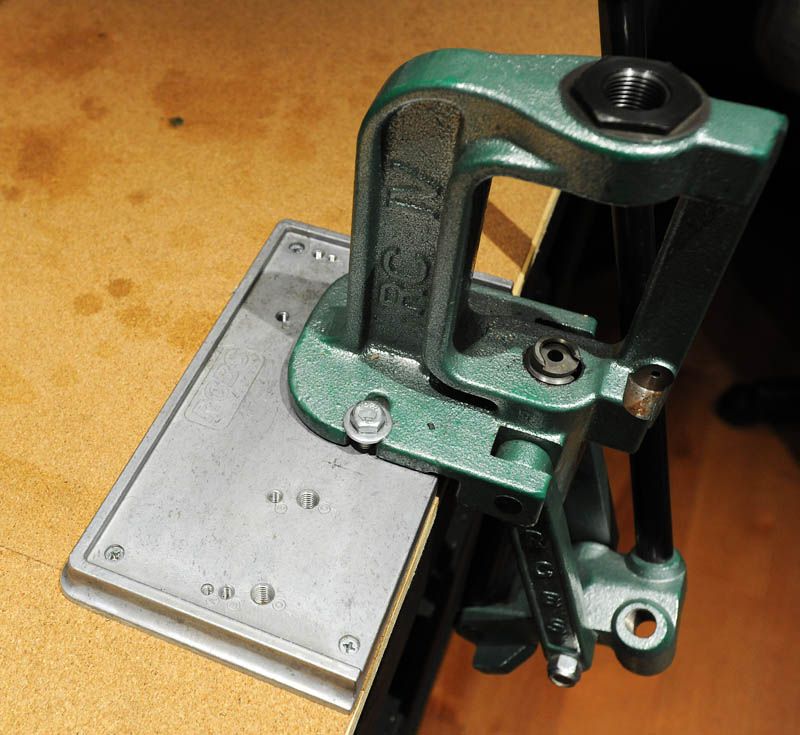

Take a look at Inline Fabrication products. They have what your looking for. Don’t have a picture of my bench but do have the ultra mount from them and change out between 3 presses and my case trimmer.
I looked at them before but never noticed the flush mount quick change base plate. That would work so I don't have anything in the way when I don't want a press there. Thanks.

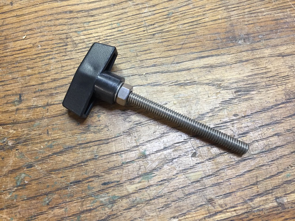

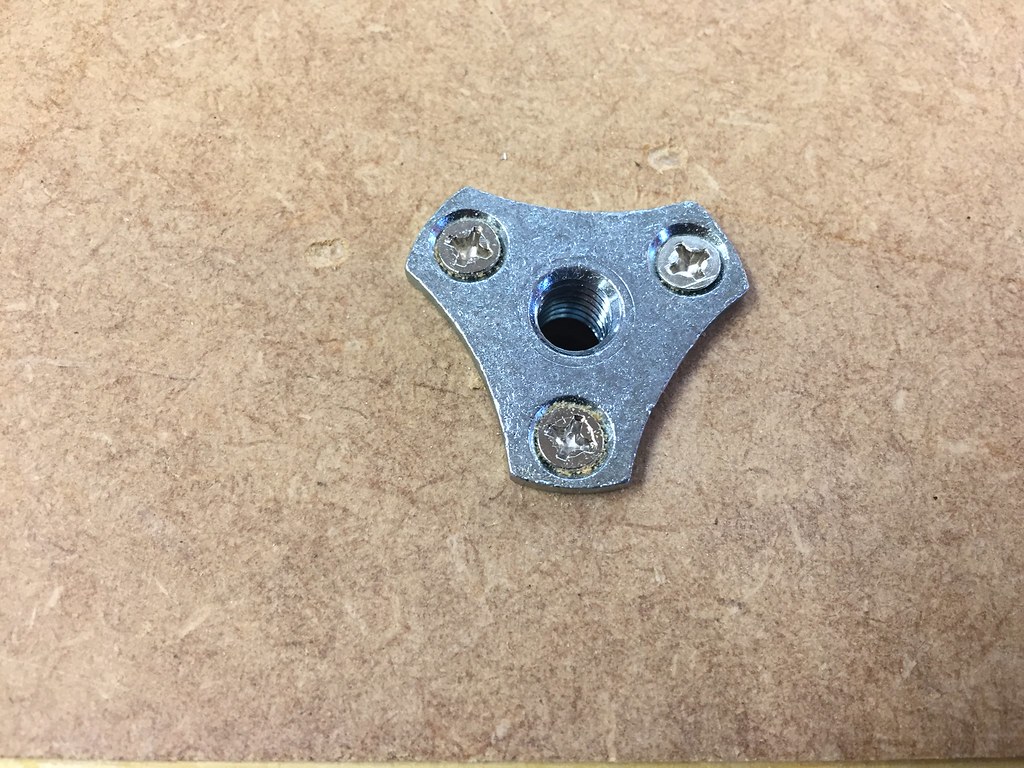

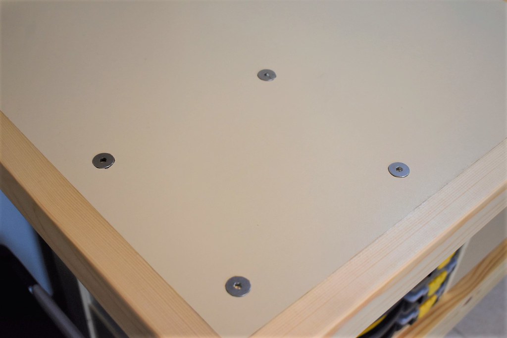

Simple bases made from edgebanded 3/4" melamine. I made up the attachment bolts from all thread and hand knobs. There are screw on tee nuts on the bottom of the top. I countersunk the holes in the top for some stainless hardware to plug the holes flush with the top when not in use. Super cheap and very strong system.
These tee nuts are very strong and make a super solid connection point.
Screw on tee nuts...
http://www.rockler.com/screw-on-tee-nuts-choose-size-thread
Hand knobs...
https://www.amazon.com/gp/product/B01DVGTE8I/?tag=accuratescom-20
Hand knobs...
Nice. I like how there is vituallly no footprint left behind on the benchtop when the base plates are removed. No large holes or slots for small componets to fall in. Looks very simple to make as well
Yes. Very simple to make and inexpensive. I use the bench for general gun work so wanted the top to be flush and without holes for screws and such to fall thru. Seems to be working well. Nothing left but the flush bolt heads. I drilled the holes in the top oversize so the stainless bolts just sit in the holes for easy in and out. No real need for them to be screwed to the tee nuts.

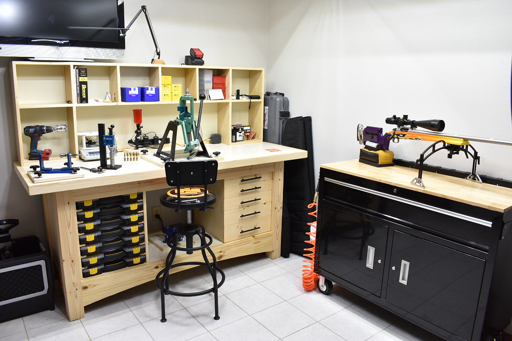

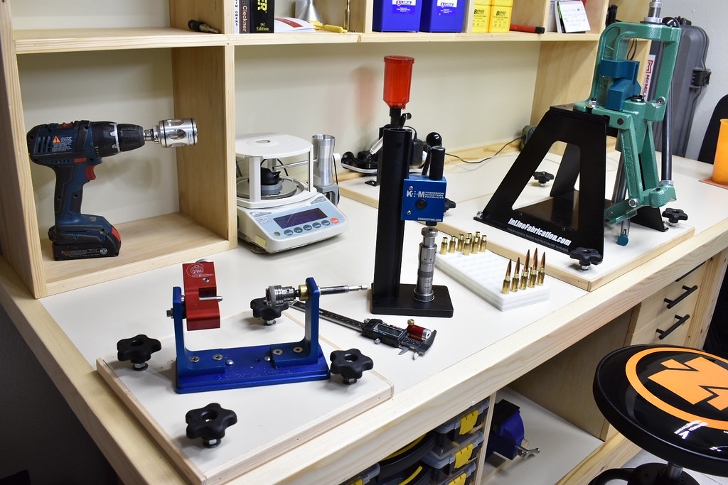

I have a set up similar to the Pat Marlin's ROCKDock. Mine is homemade but functions the same. I have a few different tools I keep permanently mounted to plates and just swap the plates as needed. I set up each plate to be able to use a couple different tools. For example, the one plate is drilled for a reload press along one edge and a cast bullet sizer/lubricator on the other side. I have about 30 bucks in materials wrapped up in the project. My reloading bench is an old, surplus, government work bench; metal frame with heavy butcher block top.
