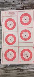

This is a Score target of mine from a couple weeks ago at Webster City, Iowa. I did the cipherin' on the target spreads...will leave the final total to those interested.

But it’s good to know that it will. This is my first target at the Gulf Coast Region last Sunday.
Lay those 30 caliber holes atop each other. Pretty good group.View attachment 1669419
Yes sir just tested mine for the VA State match and it would be a good group if overlayed as well. Makes you feel good going into a match with a practice target like this.
