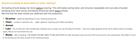

Before or after
After, with the exception being some people actually double anneal. Once before AND once after but before expander mandreling. Some believe sizing work hardens the neck a little bit so they anneal again and then expand. I never tried or had the inclination to try but if it works for them that's good.
Over heard a little range talk other day:
do you resize your fired brass before or after you anneal.
I‘ve done it both way, what about you?
Always before sizing.
Sizing after annealing, does work harden the brass some. The main points I look for is bring the brass close to the same hardness before sizing to get the sizing consistency I'm after, and of course annealing every time helps the brass's longevity.
I clean my brass after annealing and before sizing so the abrasive oxidation layer from annealing doesn't wear on my sizing dies. Then after sizing, I clean again to remove the lube.
I have no rush when I sit at the loading table. Might have to try this just for the he** of it.
Shoot em......Anneal & tumble then D-prime , lube and size ......short tumble or wipe the cases and mandrel prime and load. ( Provided they dont need trimmin )
