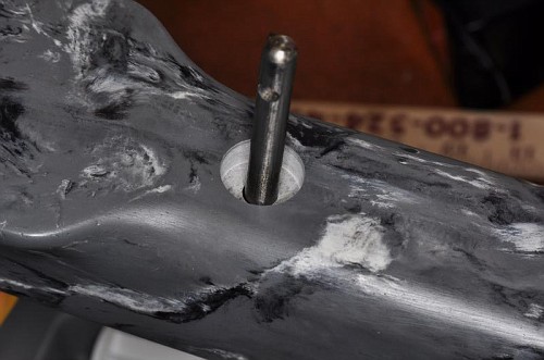

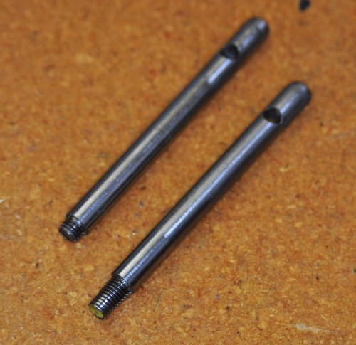

I use oversized, headless bolts that fit tightly into holes that are bored into the pillars I make. The holes bored into the rifle stock for the pillars have lots of room around them for movement and for substantial amount of epoxy.
The holes in your pillars must be approx 1/32 to 1/16" larger in diameter than your stock bolts. You do not want the stock screws to touch the sides of the pillars.
My pillars are chamfered 45 degrees and my bolt heads are the same. This centers the bolt in the pillar once everything is dry and the rifle is reassembled.
