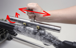

I have lapped rings where the contact was only at the leading edge of the ring, so that the scope would have to be bent slightly to make contact with the rest of the ring. My experience has been that small problems with installed ring to scope fit are hard to spot by simply laying the scope in the rings, but that a little lapping will quickly make them apparent. How many sets of rings have you lapped? I have also seen many instances where one piece bases would show a gap at one end if tightened at the other, and if installed that way( which I believe to be common) , the base would have been bent, taking the rings installed on it out of alignment with each other. In the case of two piece bases, screw holes in them have quite a bit of clearance so that there is little chance that they would be installed in alignment with each other, and even it they lined up, due to the way that factory recievers are finished they would be out of alignment in other ways. No matter how perfect rings might be, if they are installed on a base or bases that are not straight, the result will be rings that are not in alignment with each other. I would say that the majority of rifles are not based on custom actions, and for that reason I think that in those instances where, for one reason or another, the Burris rings are not chosen, that doing something to prevent a scope being bent is desirable. I also believe that ring lappers are more the exception than the rule, because most do not know that simply bolting things together may not produce the best results. We are lucky to have many really fine aluminum rings to choose from, and for that reason and the effort it takes to lap steel, I invariably choose aluminum, which takes little time and effort to lap.
The best way to think about bedded bases and lapped & bedded rings is to think of the mounting system like a well done pillar bedding job.
When you tighten the screws on a stress free pillar bedded stock, they come up 'tight' instantly. If they don't....the mating surfaces are bending and flexing to make contact. There's stress in the system somewhere.
The same is true with a lapped and bedded scope mounting system. The screws (base and rings) get tight instantly. No tightening the screws another 1/4 after they come up to a mushy semi snug.
A good indicator that you may benefit from treating the rings is how level the reticle stays when the ring tops are snugged down. Properly bedded, the reticle doesn't cant one way or another when the ring tops are tightened.
Good shootin' :) -Al
High dollar precision matched rings are only as straight as the rail or bases they sit on. So spending a ton of money on high dollar rings means absolutely nothing if everything else isnt perfect. If you think your Rem 700 or even a lot of the custom actions have perfectly straight rails or bases, you'd be wrong. To take it further, even a top dollar action that has been checked and trued for straightness can be messed up if a bedding job wasn't done properly to eliminate stress when it's torqued down.
The only way you will ever know if a set of rings needs to be lapped, is to lap them. I have some very precise alignment checking tools that would probably show various levels of misalignment on most rings that aren't lapped by people who think they don't need it.
Never once have I ever seen a set of rings, at any price point on any action, that makes over 80% contact once lapping marks reveal the true amount of contact. Usually its less than that. With proper alignment and a high quality scope, you should be able to center the reticle adjustment on the windage knob and not have to touch it when bore sighting. Windage adjustment at optical center on the scope should line up perfectly with the target centered looking down the bore of the barrel. That's when you know you got it right. If the guys who say they never lap rings are honest with themselves, they probably can't make that claim very often, if ever.
Bedding is the ONLY way to achieve 100% ring surface to scope tube contact. I use JB Weld because it's a little softer and has a grippier surface than other epoxies so it will not scratch the scope tube and holds under any amount of recoil. Can also build any amount of custom MOA compensation by doing the math and placing a small shim of the correct thickness in the bedding of the rear ring. Can shim a for a little MOA or shim it big for ELR. No need to buy expensive custom rings or use plastic inserts with a finite amount of MOA. Just do the math based on your ring spacing and bed in 10, 15, 20 MOA or even 50 MOA if you need it. After bedding with JB, I use a sharpie to label the tops and bottoms of ring for front and rear and direction they are mounted. Write on inside of rings on the JB so it can't be seen. I also write the amount of compensation built in on the bottoms. Good to keep the data written in a log book as well. Down side is that if you ever move the rings to a different rifle, the bedding will probably need to be redone.
