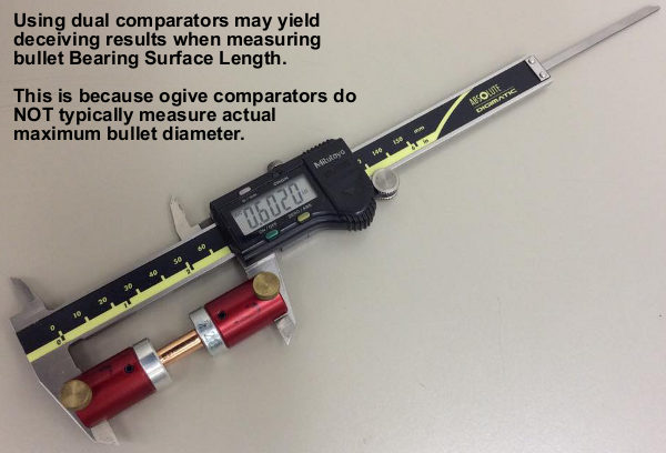

(borrowed pic from net)This is how I am performing it. As stated in pic, it probably will not match bullet manufacturers dimensions but it is repeatable and you can sort by it due to contacting the same reference point on each bullet.
I agree with you that there can be "deceiving results" with this dual comparator system, although it is marvelously conceived. There is a lot of slop in it stemming from many sources. I found that this pictured system did not deliver "repeatable results"...you must be able to get repeatable results! If you cannot supposedly measure and sort by "length of bearing service" one afternoon with your measurement system and return the next morning and get "repeat" identical measurements of what you got last afternoon, you are wasting your time.
I only started to get "repeatable results" by using a home-made point-guage system (not unlike the Tubb bearing-length sorting system; but, which I failed to get "repeatable" results on, either) using a special point-tip made by John Whidden to closely house the bullet boat tail and a barrel stub with the same lead cut from my reamer. Then, afterwards...soooooo tenderly, so tenderly bringing the bullet to bear between these two measuring points to capture a measurement.
