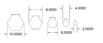

My buddy and I just welded up a KYL target frame and got our gongs back. Excited to take this to distance and see what a 215 does to them.Capture.PNG
