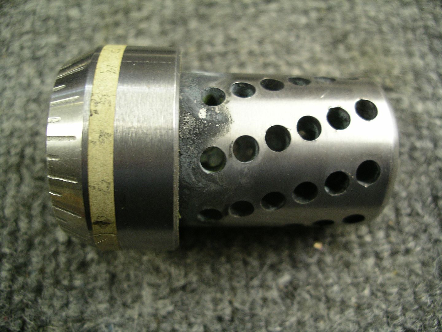

Here is a picture of the tuner/brake that I was using that was so effective and easy to tune. I don't know if this brake is being made anymore, as a friend sent the brake to me to try. I do believe that any baboon could use this brake and get stellar results.
I would love to know the maker of this tuner/brake.
It looks home-ade..... I've got several that look just like that, right down to where I didn't bother to chamfer the holes LOL
This is one of our very early RAS tuners. It is not "home-ade".We have since greatly improved the looks but the function is the same. I have been watching this thread with interest. I have not wanted to chime in but someone asked who's tuner it is so I answered.Fun to read all of the opinions some have. Especially those who have not shot thousands of rounds testing tuners. Thanks. Eric
Ras tuner break Bostrom gun smith sell them The new ones have 56 thread per inch the threads
That looks like an early model of the RAS TB150 tuner
