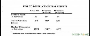

The problem with this kind of thinking is it's applying a discontinuous mindset to a continuous process. Throat wear is a continuous process which is aggravated by increases in temperature. It's not that it's sustaining damage after some magical temperature point. It's how much damage is it sustaining at tempX compared to tempY on a per shot basis and how much that grows with temperature. The barrel is always taking some damage with every shot but shot to shot is essentially unmeasurable. Get a barrel 1 degree hotter than any arbitrary point and it will take more damage per shot, just probably not measurably more. The military did formal studies, heat kills pipes. The rule of thumb is about the best we have because you have to accept some barrel heat or no kind of match shooting will get very far and plinking would be declared evil (I'm looking cross eyed at those guys that mag dump into dirt right now).
