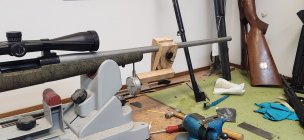

Picture of the tool I made. I’ve only used it with rifle vertical, and only a few times. But measurements seem to repeat very well
Nice looking unit.

Nice looking unit.
When I decided that I needed one, I was in a frantic time crunch(what's new!).
I whomped one up out of a couple of maple scraps using the table saw and drill press. It's so ugly that I won't post a picture of it, but it works great, and the wooden jaws are very kind to barrel finishes.
It's also biodegradable and carbon neutral.
Thanks. Hey, I bet my pine hack is uglier…..but it worked ok too.
