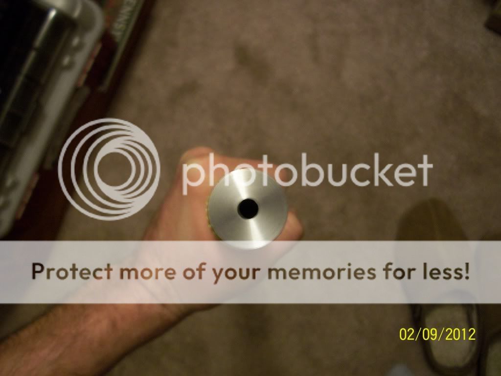

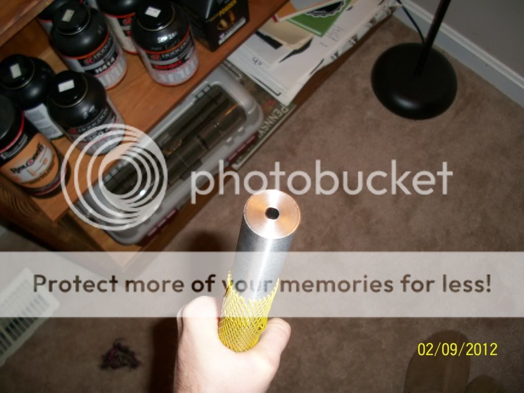

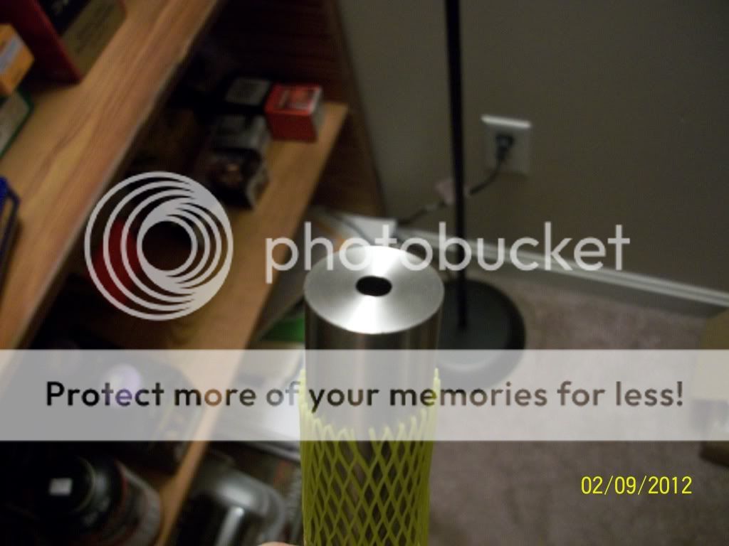

I just picked up my barreled action from my FFL today and noticed that there is not really any crown on it that I can tell, atleast not recessed. I'm unable to reach the gunsmith this evening (the smith is very highly regarded) and wanted to post here to get input.
Granted we never spoke on the crowning, I pretty much assumed it was a package deal with a chamber job. Also I didn't just get a chamber job from the smith, there was much more work done on the barreled action. The smith is very well known for short range benchrest, and this is my first short range build so I'm not sure if a recessed crown is standard in this field or not.
It looks like you got a flat crown. A few gunsmiths have done the same on my target rifles. I,m seeing more high end BR rifles with the same.
A recessed crown would be a "must" for me. Talk it over with your smith and see what he says. He is the one you'll be talking to if there is some issue, so IMHO by all means get his input on it. WD
You are good to go. I understand a 90 degree flat crown is easier to make perfect. I'm not a machinest so I don't know that for sure but it makes sense to me.
I don't see a need for a recessed crown unless it is a hunting rifle and there is a chance of damaging a crown. I've yet to see a need on a benchrest rifle.

My smith, Billy Stevens: http://www.stevensaccuracy.com/ always recesses the crowns on my Light Varmint and Heavy Varmint barrels that are tapered Krieger's. When it's recessed it provides greater protection for the rifling. Also, the barrel in the photos looks like a Bull barrel, that's normally associated with a much heavier barrel than the Heavy Varmint. To my recollection Bull barrels are only seen locally in fun matches, vice competitive matches, due to weight restrictions. The LV being 10.5 lbs and the HV being 13.5 lbs. Personally, I've never seen a 6PPC with a Bull barrel. They look neat, but you won't see them in big registered matches.

potatoe: am i missing something? your photos depict a barrel blank still in the mesh sleeve. second photo is the blank all by itself. as we know, the muzzel end of a blank is removed with about 1 in of barrel. what does the barrel look like in the action? i have banged the muzzel of all my guns at some point and am very thankful that my crowns are recessed.
:D Somehow I managed to get the pics to hide the rest of the barreled action. The mesh was left on the barrel after chambering for shipping. The pic is of the barrel attached to the action, chambered and crowned.
I did talk to the smith this morning and it is a flat target crown, I was not aware that they did such crowns.
