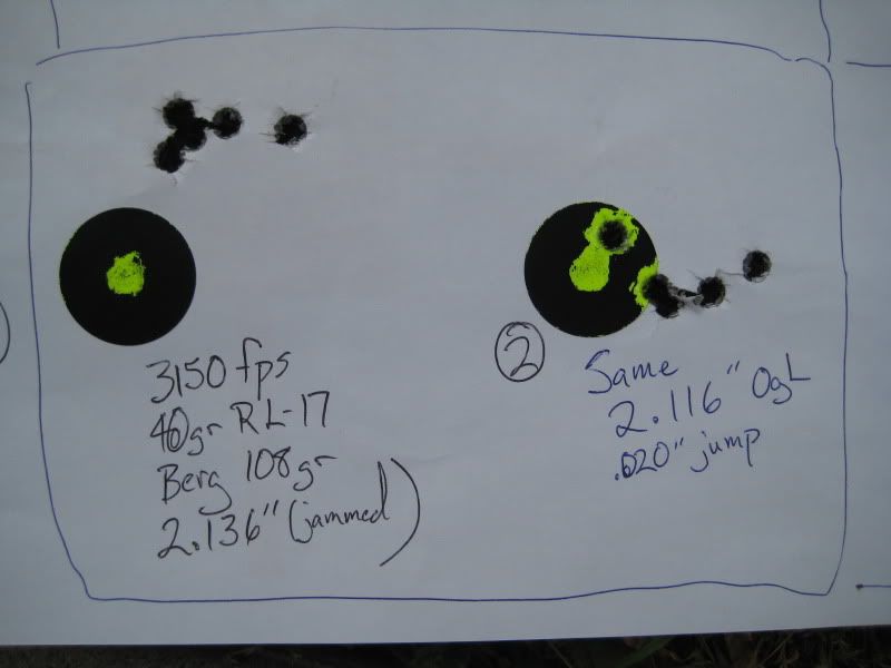

I shot my 6 x 47L with the brake removed last week - accuracy wasn't any better = about 1.1" ave at 200 yds. I'm not an experienced BR guy but wanted better results than that.
Before heading out this morning I made the following changes:
- added 1.5 lbs lead to the butt of my McM A-5 to offset the extreme muzzle heaviness
- Switched from 107 SMK's to Berger 108's.
- Arrived at the range at 8:30 am so I could shoot before wind and mirage came up.
My gun:
Pierce single shot action
Krieger 27" bbl with Holland brake
Jewel trigger ~ 4oz
McM A-5 non-adjustable stock
Sightron 10-50 x 60 1/8" dot
In each photo the right hand group is same load as the left, with bullets seated .020" shorter. My RCBS thingie shows my loaded ammo with less than .001" runout.
Groups were shot at 200 yds.
I also tried the 107 SMK's. My gun just doesn't like them, not the way I've loaded them anyway.
Looking at your targets though it seems as though there is a lot of gain to be had in further load development and technique well before the crown. There are some great groups in amongst it all. :-) The two jammed loads for 108 Bergers are nice (9 fantastic with one horizontal flier - perhaps wind or technique) but a little bit of difference vertically in their position even though only 0.5gr apart -((although 100fps??)). I would suggest you need to explore around there a bit more. Perhaps 39- 40.2 grains in 0.3 gr increments plus fine tune your neck tension / jam jump depth etc.. Feelings are the 6*47 is trickier to tune than a 6BR so keep at it. Don't worry about the crown yet. There are some very good signs amongst all that.
If you still aren't happy with it - you can give it to me..... ;D
Thanks Camac. Note the velocity difference is due to different powders - RL-17 vs H-4350 in the second photo.
I was shooting off a bipod rested atop carpet to help fight the bounce. I don't own a good front rest yet.
Those two best groups were kind of exciting for this rank amatuer. If I can replicate them with the same loads that's all the accuracy I need from this gun for the informal long range plinking and prairie dogging I want to do with it.
