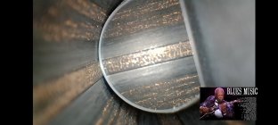

This takes soaking a little ! Cr10 & bortec, losso got it out
