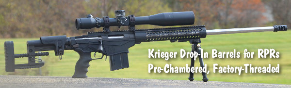

After a thorough cleaning and muzzle inspection, if the results don't improve significantly, get a Krieger Pre-fit.
KRIEGER RPR Pre-Fit Barrels:
https://direct.kriegerbarrels.com/rpr
Krieger Barrels is now producing Pre-Fit barrels for the RPR in seven popular chamberings: 6XC, 6mm Creedmoor, 6.5 Creedmoor, .243 Win, 6.5 PRC, .308 Winchester, and .300 Win Mag. These $550.00 “Drop-In Ready” barrels come finish-chambered and threaded to fit the Ruger action. The Ruger barrel attachment system allows correct headspace with a pre-chambered barrel. Krieger explains: “Thanks to Ruger’s proprietary barrel nut design, a competent gunsmith will be able to swap out your barrel using an AR15 barrel wrench and proper headspace gauges.”
