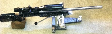

Here's my second switch barrel Barnard P action Vee block F-open option from MT in a 6 dasher. Have a 284 and 6 Dasher now.
Just got the new barrel from SABRECO yesterday and out for load tests this weekend.
