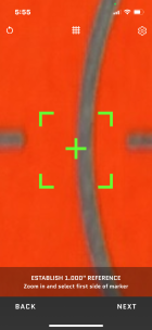

An inch is exactly an inch if you are claiming groups to the 2nd digit so I magnify to not make measuring mistakes and regain my lost 20/20 vision. it only takes a micro second to magnify
Not even sure what that blurry mess is supposed to be. I zoom in where I can comfortably center the marker in/on the line, as shown in the pictures I posted above. More than that... I can't see how it's useful. The marker is already jumping around pixel by pixel.
Yes, that's what I just did in the screen recording.
I dont see what the problem is?Other than you did not set your 1 inch exactly. you need to be on the same line and not cross from one line to another and get diagonal in the play.. And you didnt set your shot placements correctly because you were not zoomed in, If you zoom in the circle gets larger in proportion to the bullet hole 243
okay...let me show you again by digging out a target and taking a fresh pic, instead of using an old one which makes it blurred. The outsides of the lines are 1.00 and the insides are .94, as an example on this pasty. So if you want to measure precise with this app then atleast use the zoom to do it! Get it now? Might be half blind but not dumb.AEEF69D1-9A3A-4239-9C73-261AC4BDF094.png
I have no idea what you are talking about. I don't have an issue. I'm fully aware of how to use the app and how to zoom. I made the screen recording hoping it would help the OP. The screen recording was meant for demonstration purposes and not meant to be precise to .001"

When you say you are setting the1” reference points are you setting this with a touch screen or by pressing a key? I’ve tried both. Get one marker in place and have both touched the screen and pressed ‘enter’. No good. Can’t get the first marker to stay in place to get the second.

Neither. One you have the marker where you want it (after zooming and scrolling) just press next, and then repeat the zoom and scroll and needed.

I mark a 1” measurement on the target before taking the pic. Then in the app I too zoom in to set my 1” reference and to mark the shots. Not to the point of it being blurry though.
I figure If the reference measurement isn’t accurate how do you expect the group measurement to be?
Pretty sure memilanuk isn’t zooming cause he is”blind”, and is doing it to be more precise.

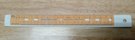

I installed the Ballistic-X about 6 months ago and tried it back then, it worked. I had not used it since until this thread was started. I use OnTarget and scan paper targets, take a photo of steel for OnTarget. It's much easier and more accurate to use the OnTarget than Ballistic-X for my purpose. I also have this MOA ruler in my bag to use in the field.
