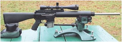

EGW makes a “Bag Rider” that quickly installs and removes. This may be the ultimate item to very accurately shoot ¼ MOA bench rest groups with the AR’s round hand guard. If the front Bag Rider had a recessed Picatinny rail that would accept Arredondo’s quick mount bipod adapter I’d leave it installed all the time for support on props in match shooting.
See demo:
http://www.youtube.com/watch?v=UdkAiCSso9g
More info at:
http://accurateshooter.wordpress.com/
If you are interested call them at 1,215) 538-1012 because their web page tried to plant a Trojan virus when I went to it today. I notified them by voice mail and I expect it will be cleaned soon.
Steve Harris
