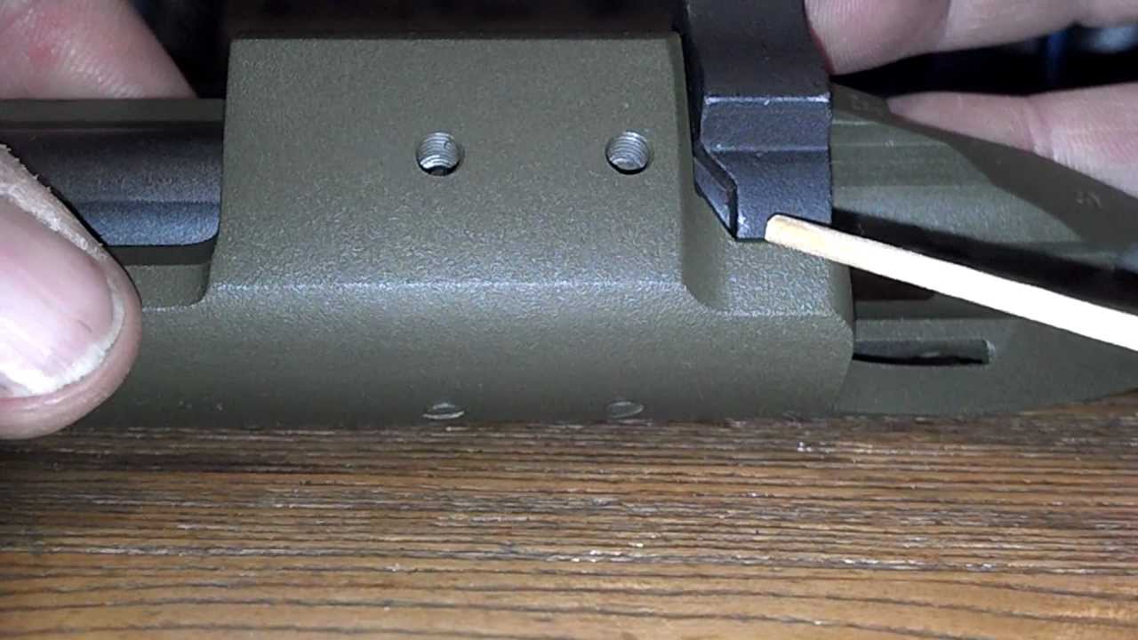

When lifting your bolt has a noticeable hitch at the top of the opening, it's the camming/ramp surface on the bolt hitting the ramp on the action. It's trying to pull the brass from the chamber and it's difficult because it's grown too much - usually near the case head.
