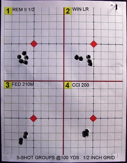

One of my biggest seller remorse guns was an RRA LAR-8 Predator HP with its cryogenic treated 20" barrel. It shot groups using 168gr Amax's over 41.7gr AR-Comp @ 2.80 COL, like this primer test at 100 yds. Absolutely loved CCI 200's
The worst part is I still keep in touch with the former co-worker who I sold it to and keep trying to get him to sell it back. He said that it just sits in his safe, unfired since he bought it from me back in 2008. He said that if he dies before me (unlikely), that I get first rights of refusal from his estate. Haunts me... :(
